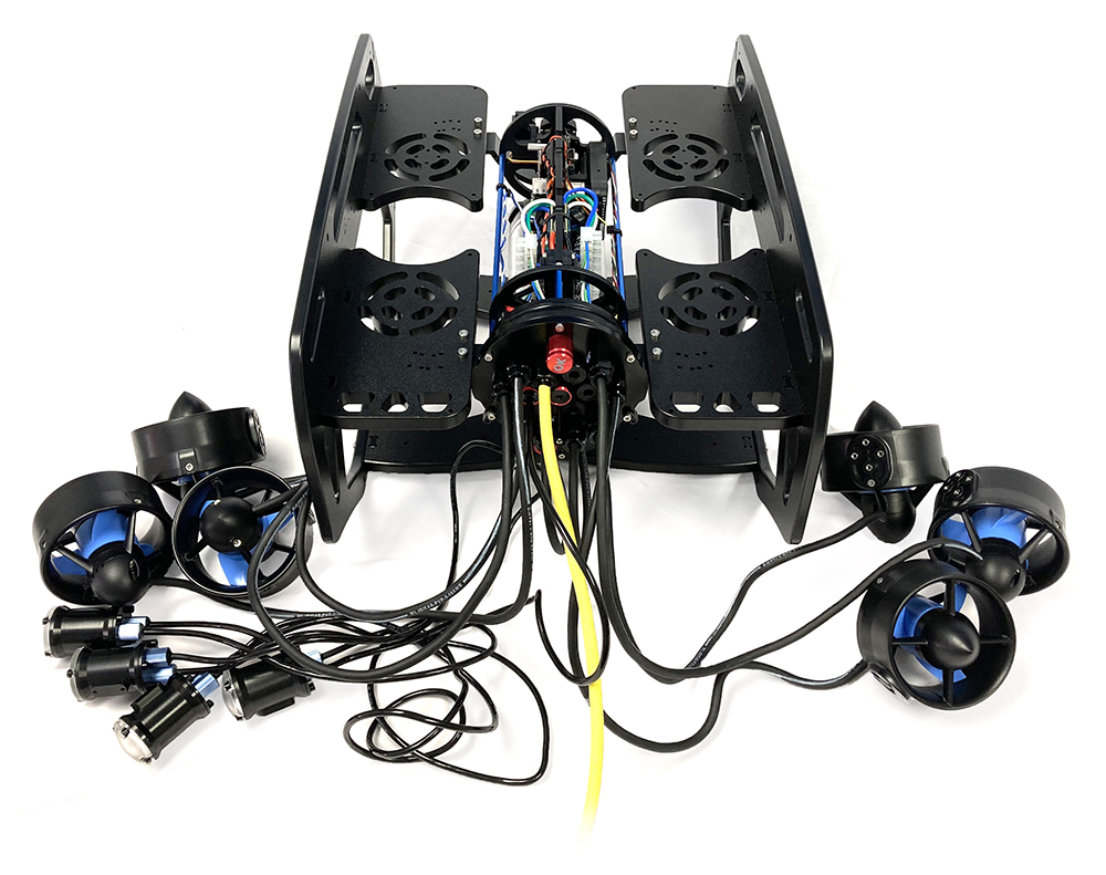

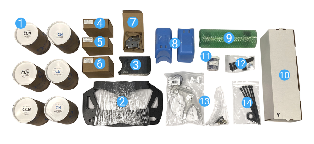

1. Unpack the BlueROV2 kit. You should find the following components and sub-assemblies:
Kit Contents
Kit Contents
  1. T200 Thrusters, 3x clockwise (CW) and 3x counter-clockwise (CCW)
  2. Bottom and side panels
  3. Center panels
  4. Cradles for 4″ watertight enclosure
  5. Clamp for 3″ watertight enclosure
  6. Fathom-X Topside Interface (FXTI)
  7. Box with ballast weights
  8. Fairings with installed buoyancy foam (4)
  9. Battery Enclosure with bag of small components inside
  10. Box with Electronics Enclosure
  11. Container with desiccant bags
  12. Bag with extra leak sensor sponges, leak sensor tester, SD card adapter, zipties, and sticker
  13. Hand Operated Vacuum pump and bag with vacuum hoses and fittings
  14. Tether thimble and large zip ties

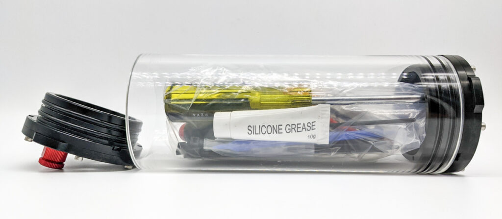

2. Open the Battery Enclosure by pulling off the end cap and flange assembly.
brov2-assem-batt-enc
Inside you will find a bag with the following small tools, components, and screws required to complete assembly:

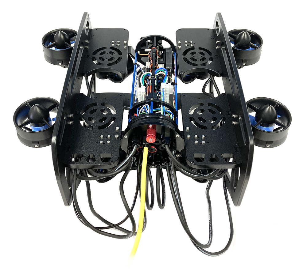

Now the BlueROV2 should look like the picture below.
frame-assembled

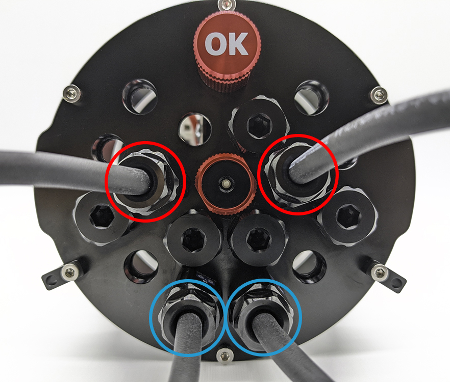

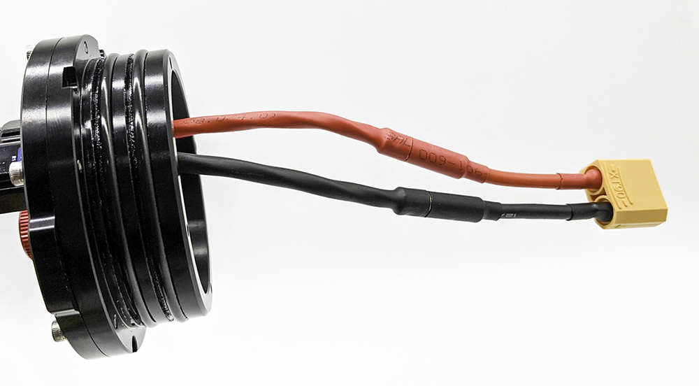

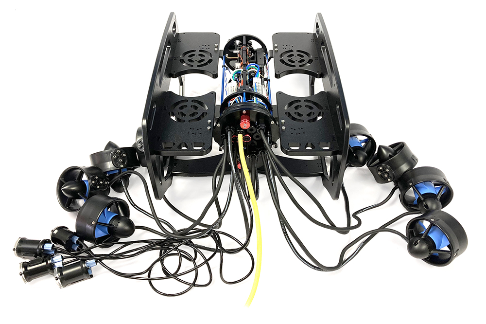

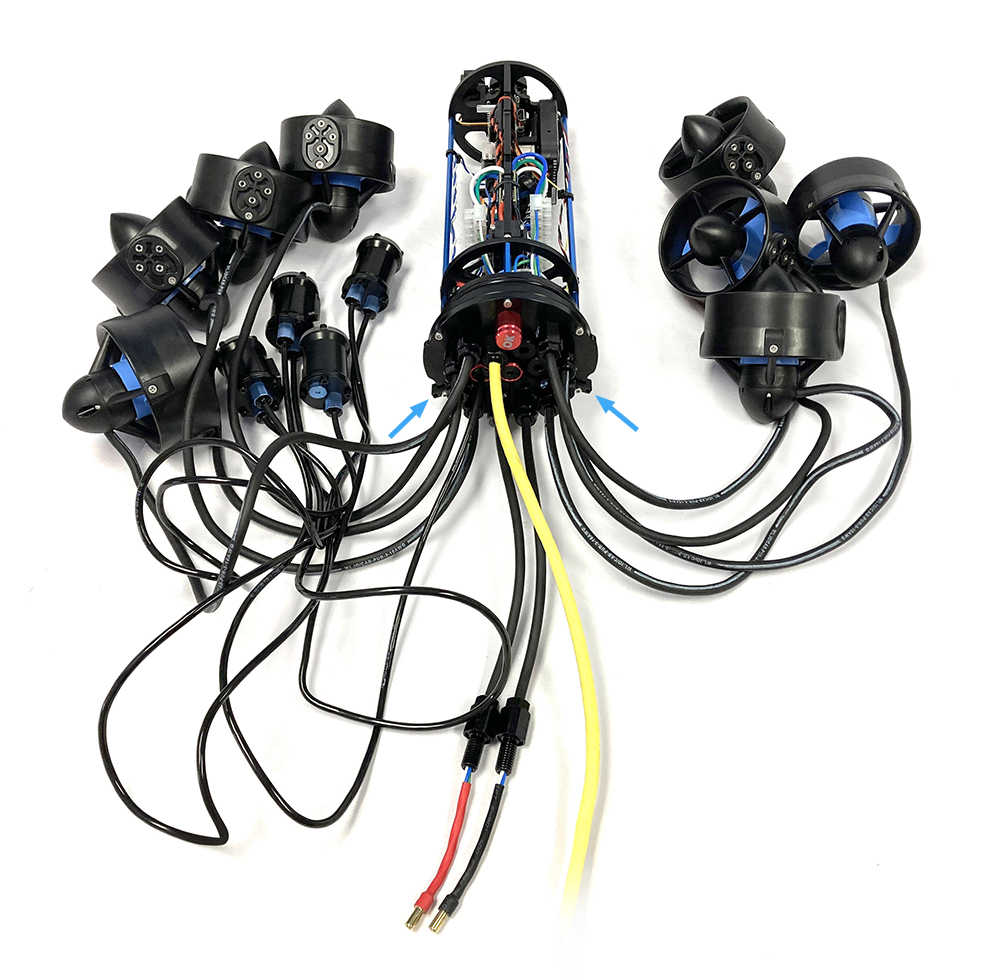

1. Pull out the ends of the power cables that are in the holes marked in red below from the Electronics Enclosure end cap. They are not secured with anything and should pull out easily. The other ends of the power cables, marked in blue below, should remain securely installed in the 18 hole end cap.
brov2-assem-endcap-powercab

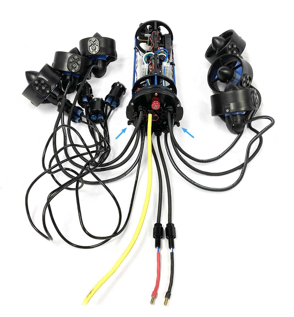

2. Separate the Watertight Enclosure tube (4″ Series) with Dome End Cap installed from the rear O-Ring Flange (4″ Series). If this step is difficult, you can place a large flat head screwdriver into the slots on the O-Ring Flange (4″ Series), and then twist to get a gap between the acrylic tube and the O-Ring Flange (4″ Series). Once you have the gap, you can wedge a screw driver between the end of the acrylic tube and the O-Ring Flange (4″ Series) to finish removing the acrylic tube.
electronics-assembly-step1
3. Remove the Aluminum End Cap with 18 Holes by removing the six M3x12 screws using the 2.5 mm hex driver. Place the M3x12 screws and extensions (small L-shaped parts) in a safe place. There is a face seal O-ring that sits in a groove between the end cap and flange, ensure this O-ring stays seated in this groove or place it somewhere where it will not get dirty or damaged.
electronics-assembly-step2-annotated

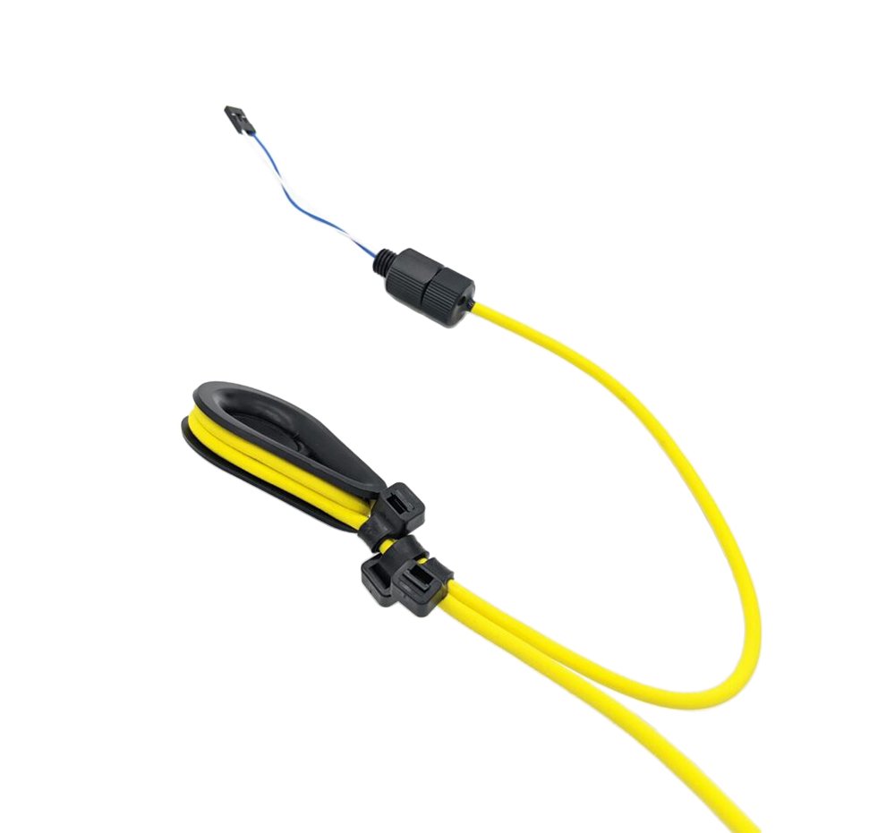

  • 1 x Fathom ROV Tether with O-ring and penetrator nut from one end of the tether

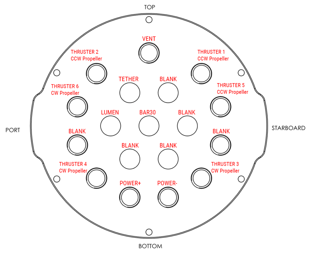

The Aluminum End Cap with 18 Holes comes with five blank penetrators, one Bar30 Pressure Sensor, one Enclosure Vent and Plug, and two power cables preinstalled.
brov2-assem-endcap-starting

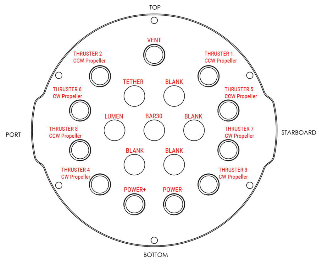

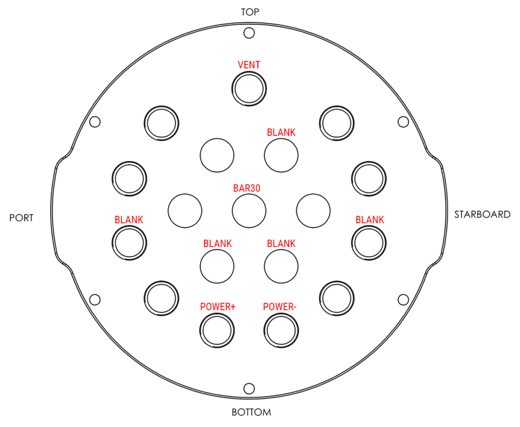

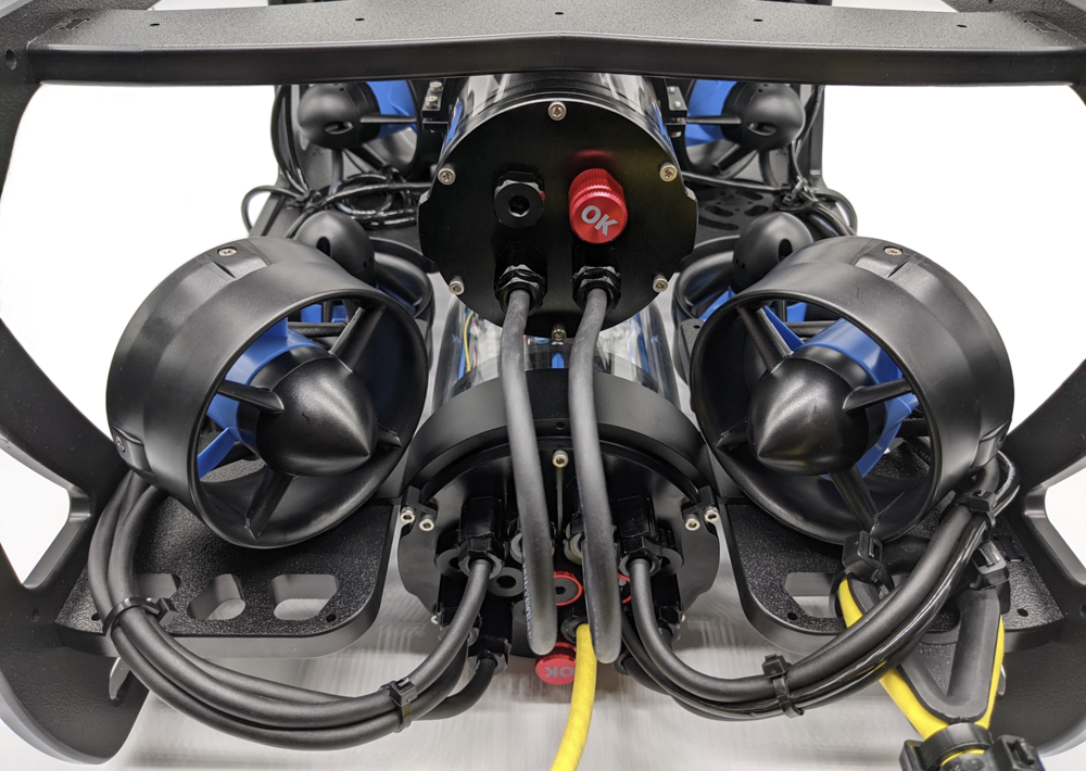

If you install the remaining penetrators as shown in the diagram below, it will keep everything neat and organized.
brov2-assem-endcap-final-1
6. Install the penetrators to the end cap in the order shown below. Tighten to finger tight, then use the provided Bulkhead Wrench to tighten them an additional ~1/16 of a turn. If you can’t loosen them with your fingers, they are tight enough. If using a torque wrench, tighten to 3.5 Nm. Penetrators installed in the threaded penetrator holes along the outside of the end cap do not require a penetrator nut. Penetrators installed in the through holes require a penetrator nut.
  1. Lumen penetrator and nut or blank penetrator and nut if not installing Lumens
  2. Blank penetrator and nut installed to the right of Bar30 Pressure Sensor
  3. Thruster 1 (CCW propeller)
  4. Thruster 5 (CCW propeller)
  5. Thruster 3 (CW propeller)
  6. Thruster 4 (CW propeller)
  7. Thruster 6 (CW propeller)
  8. Fathom Tether with penetrator nut
  9. Thruster 2 (CCW propeller)

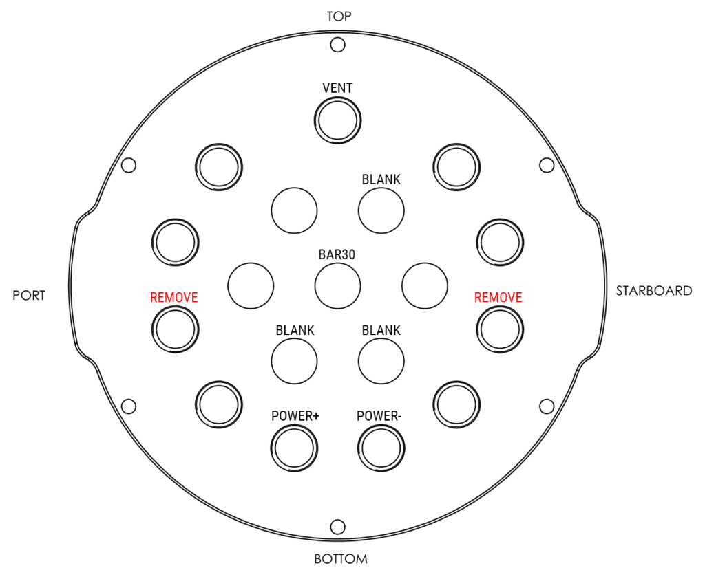

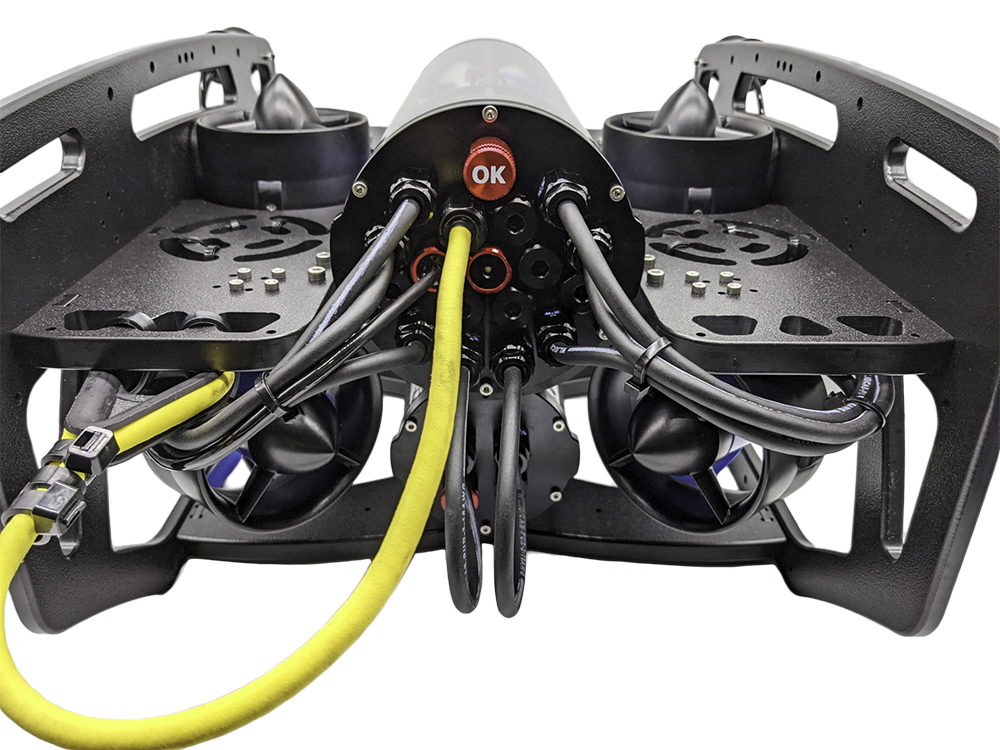

6. The Aluminum End Cap with 18 Holes comes with five blank penetrators, one Bar30 Pressure Sensor, one Enclosure Vent and Plug, and two power cables preinstalled. Use the Bulkhead Wrench to remove the two blank penetrators marked below from the end cap and set them aside, they will be used in the next step.
brov2-assem-endcap-remove
brov2-assem-endcap-final-heavy
7. Install the penetrators to the end cap in the order shown below. Tighten to finger tight, then use the provided Bulkhead Wrench to tighten them an additional ~1/16 of a turn. If you can’t loosen them with your fingers, they are tight enough. If using a torque wrench, tighten to 3.5 Nm. Penetrators installed in the threaded penetrator holes along the outside of the end cap do not require a penetrator nut. Penetrators installed in the through holes require a penetrator nut.
  1. Lumen with penetrator nut or blank penetrator and nut if not installing Lumens (use a blank penetrator from the previous step and a penetrator nut from the bag labeled “Blank Penetrator [4]”)
  2. Blank penetrator and nut installed to the right of Bar30 Pressure Sensor (use a blank penetrator from the previous step and a penetrator nut from the bag labeled “Blank Penetrator [4]”)
  5. Thruster 7 (CW propeller)
  6. Thruster 3 (CW propeller)
  7. Thruster 4 (CW propeller)
  8. Thruster 8 (CCW propeller)
  9. Thruster 6 (CW propeller)
  10. Fathom Tether with penetrator nut
  11. Thruster 2 (CCW propeller)

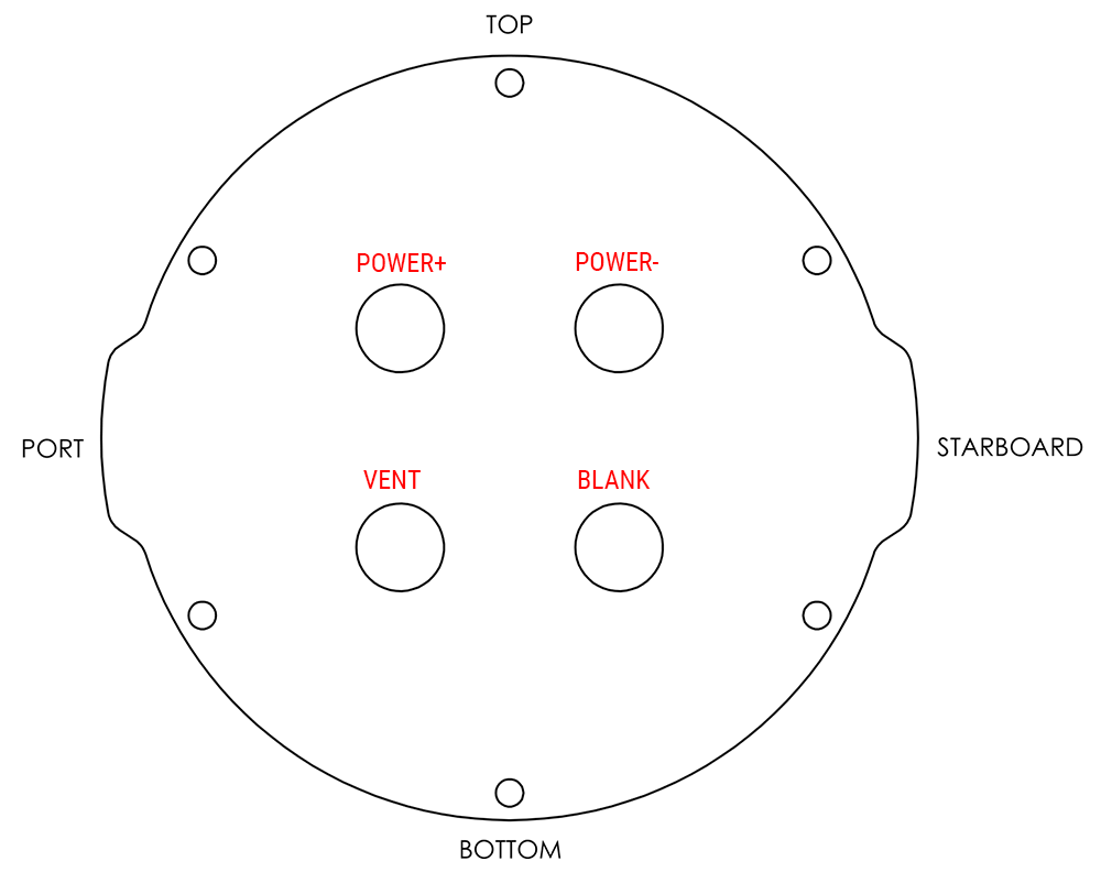

1. Take two O-rings and two penetrator nuts from the bag labeled “Blank Penetrator [4]”. Apply silicone grease to the O-rings.
2. Install an O-ring on the penetrator at the free end of both battery power cables.
3. Install the battery power cable penetrators into the openings in the Battery Enclosure end cap so they match the diagram below. The battery power cable with red heat shrink wrapping is “POWER+” and the cable with black heat shrink wrapping is “POWER-“. Use one penetrator nut for each battery power cable and tighten to finger tight, then use the provided Bulkhead Wrench to tighten them an additional ~1/16 of a turn. If you can’t loosen them with your fingers, they are tight enough. If using a torque wrench, tighten to 3.5 Nm.
brov2-assem-batt-enc-endcap
4. Install the XT90 to bullet connector adapter to the battery power wires. Match the heat shrink colors of the adapter to the heat shrink on the power wires.
brov2-assem-xt90-batt
Ensure the heat shrink around the bullet connectors does not slide down during this step. If the heat shrink slides down and exposes the metal connector, slide it back in place.

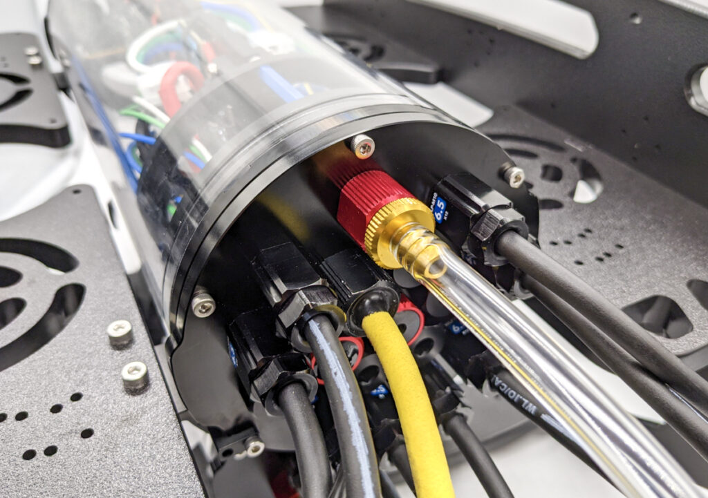

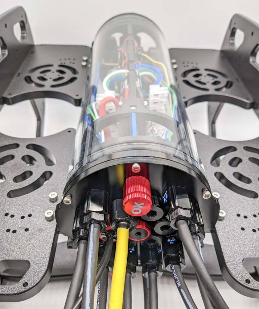

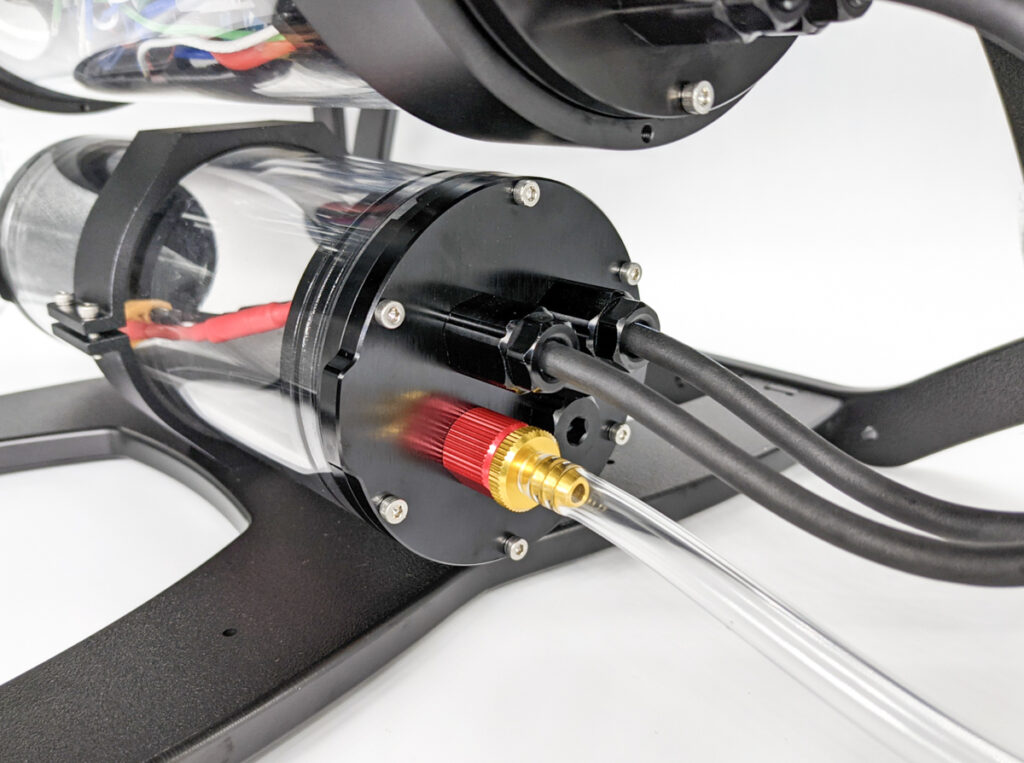

Performing the Test
Watch the video tutorial or follow the written instructions below for performing the vacuum test.
1. Test your vacuum pump to ensure that it is not leaking. See our Testing the Test Setup Tutorial for detailed instructions.
2. Insert one of the vacuum plugs into the Battery Enclosure vent penetrator.
brov2-assem-2
3. Insert the other vacuum plug into the Electronics Enclosure vent penetrator.
brov2-assem-3
Both the Electronics Enclosure and the Battery Enclosure need to be tested at the same time using the included pump and vacuum tee. Testing only one enclosure at a time may result in the pump gauge reading below the acceptable level.
4. Turn the knob on the side of the vacuum pump so it is in the “VACUUM” setting.
brov2-assem-7

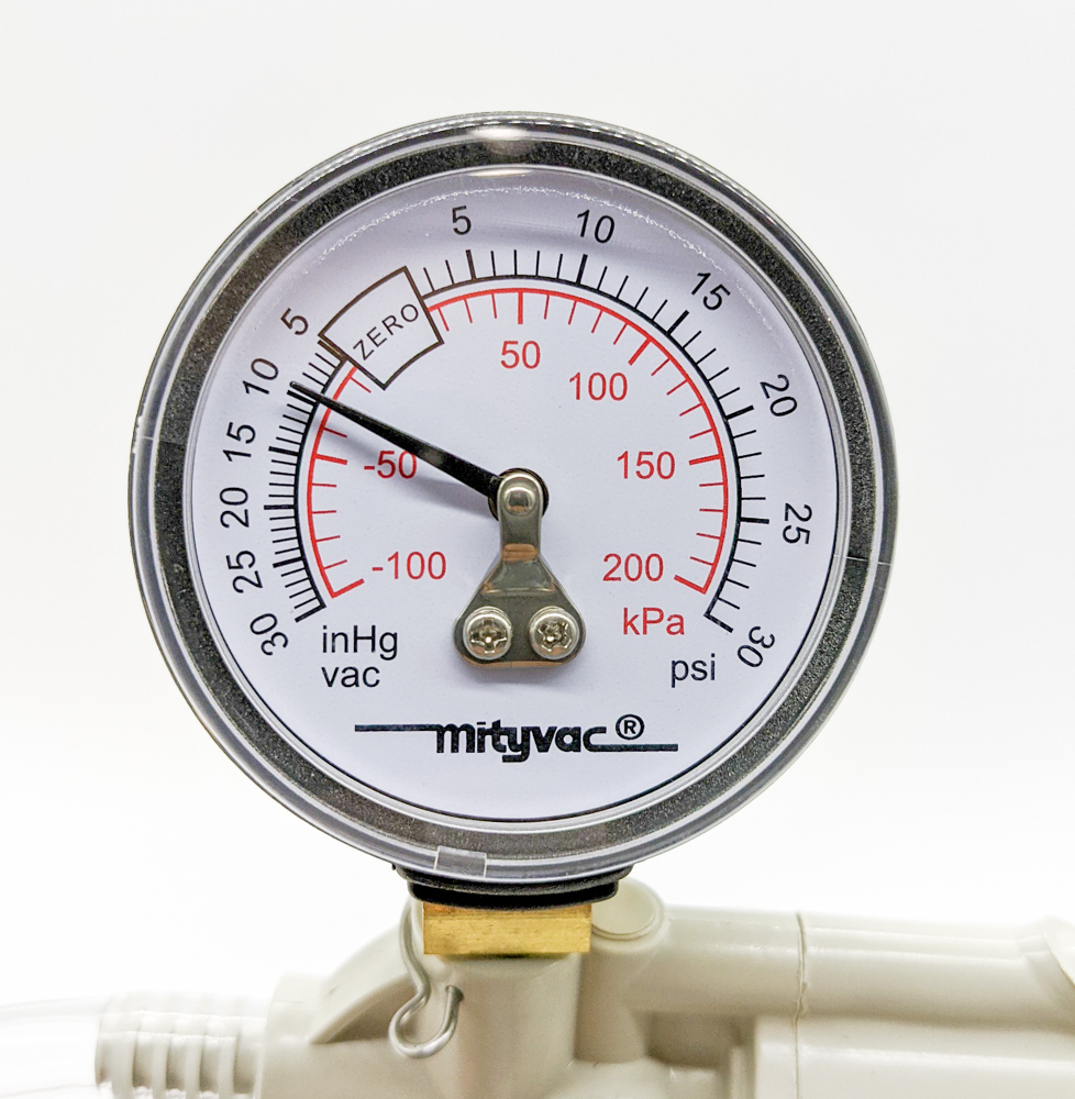

5. Pump the vacuum until the gauge reads 10 inHg [34 kPa] vacuum. If you cannot pull a vacuum, try the suggestions following step 7, below.
It may take quite a bit of pumping before the gauge starts to move. On average it should take 140 to 145 pumps using the provided Mity-vac pump to get to 10 inHg.
brov2-assem-5
6. Let the BlueROV2 and pump sit for 15 minutes.
7. If the gauge reads 9 inHg [31 kPa] or above after 15 minutes, your seals are acceptable.
brov2-assem-6
If the gauge reads below 9 inHg [31 kPa] vacuum after 15 minutes, you should check the following:

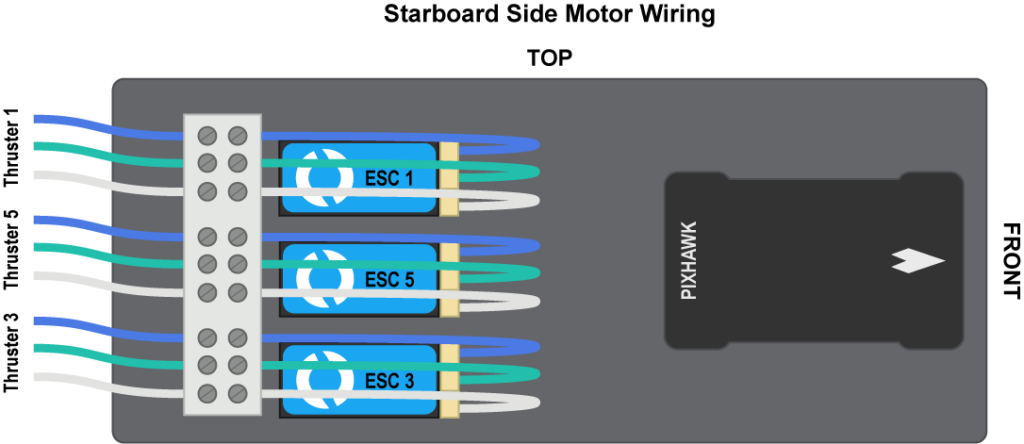

5. Connect the thruster motor wires to the motor wire terminal blocks, match the thruster number to the ESCs as shown in the diagrams below. Use a small (~2 mm) flat head screw driver to loosen and tighten the connectors on the motor terminal blocks.
etray-fathom-x-side
etray-pixhawk-side

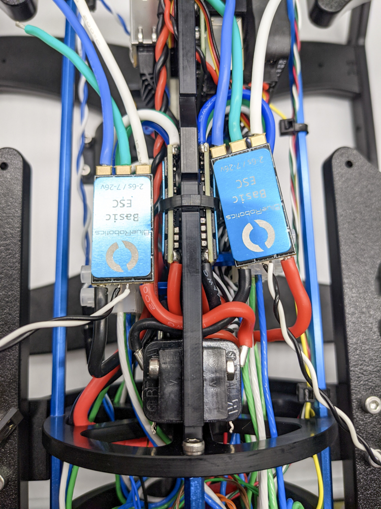

To install the additional ESCs from the heavy kit you will need the following parts and tools:
  • 2 x Basic ESC (from Heavy Retrofit Kit)
  • 2 x 3 Pole Euro Terminal Block (from Heavy Retrofit Kit)
  • 1 x #2 Phillips head screw driver
  • 1 x Small (~2 mm) flat head screw driver
1. Connect the ESC power wires onto available screw terminals on the power terminal blocks. Use the cut outs in the electronics tray to route ESC power cables to the correct power terminal block as necessary. An ESC should be installed on each side of the Electronics Tray.
brov2-assem-heavy-esc
2. Connect the motor power wires from thrusters 7 and 8 to the ESCs using the 3 pole Euro terminal blocks and your 2 mm flat head screw driver. Slide the 3 pole Euro terminal blocks under the aluminum standoffs so they sit between the standoff and the 9 pole Euro terminal blocks as shown below.
BlueROV2 Assembly (R3 Version)
3. Plug the ESC signal wire from the ESC connected to thruster 7 into channel 7 on the Pixhawk with the white signal wire oriented toward the bottom of the Pixhawk. Then plug the ESC signal wire from the ESC connected to thruster 8 into channel 8 on the Pixhawk with the white signal wire oriented toward the bottom of the Pixhawk. Use the cutouts in the electronics tray to route the wires as necessary.
4. Secure the ESCs to the tray using one zip tie each and lightly wrapping them around the other ESC motor power wires.

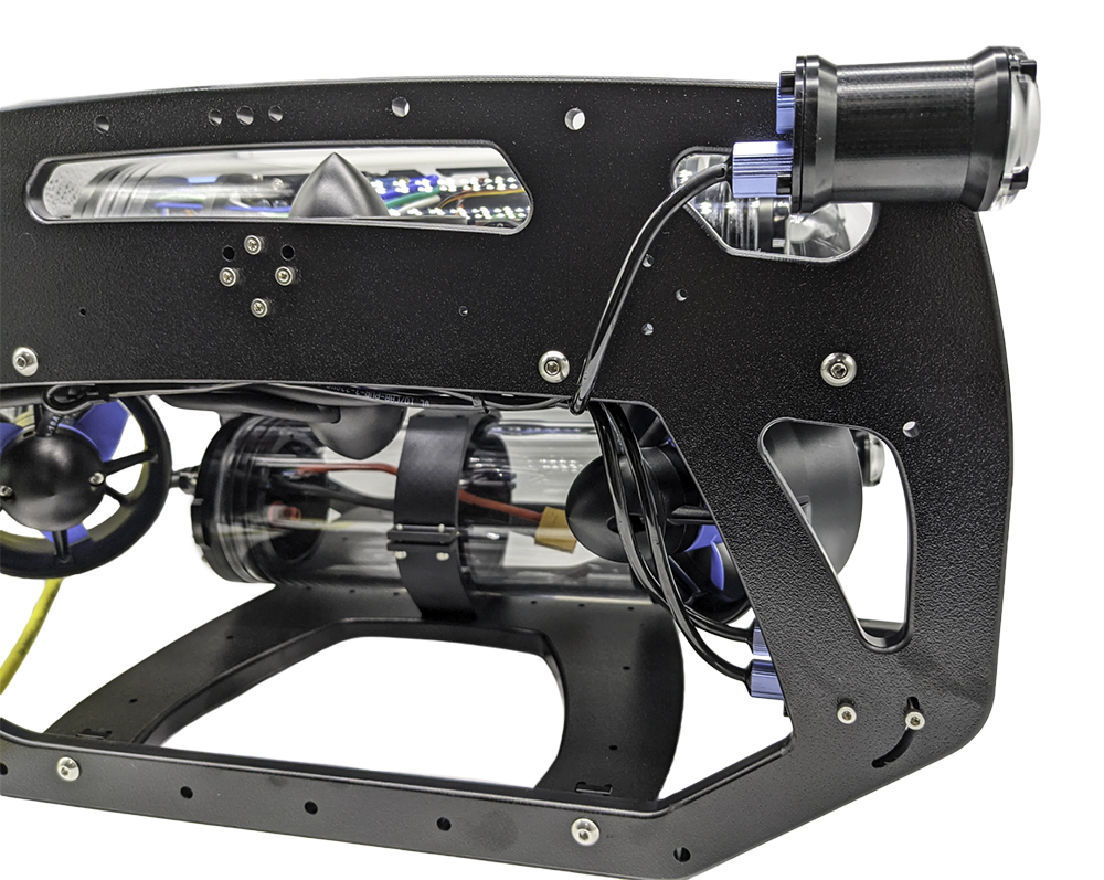

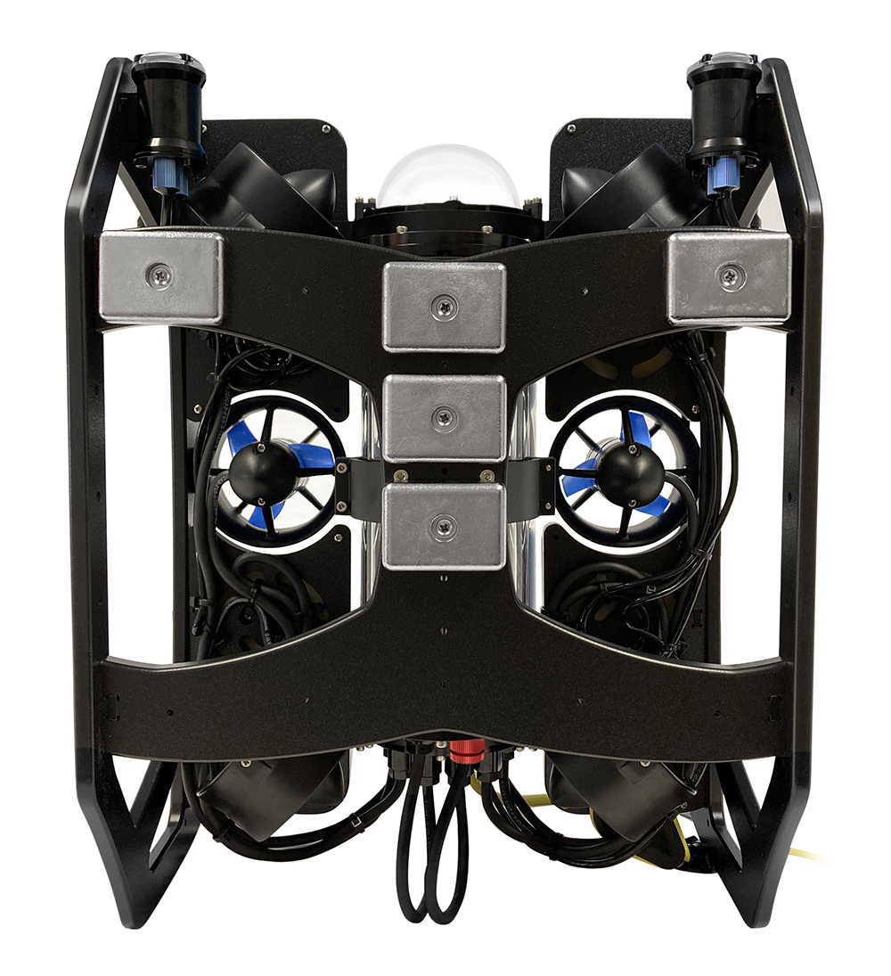

Mounting the Lights
To install the Lumen mounts you will need the following parts and tools:
  • 1 x Assembled ROV frame
  • 1 x Bag of M3x12 from box of Lumen Subsea Lights
  • 1 x 2.5 mm hex driver
  • 1 x Threadlocker
1. Find the bag of M3x12 screws included with the set of Lumen lights. Apply one drop of threadlocker to each of the M3x12 screws. Roll the screws around on a paper towel to evenly spread the threadlocker and to remove excess threadlocker.
2. Install the Lumens in the locations specified depending on how many light pairs you have. Lights mounted in the bottom mounting positions can be installed inside or outside the frame. Installing the lights outside the frame reduces the amount of backscatter the camera sees. Lights installed inside the frame may have limited tilt positioning ability. Route the cable that connects the lights on either side of the frame through the middle of the ROV, underneath where the Electronic Enclosure will go.
3. Adjust the Lumens to the desired angle in the slot and tighten the screws. Be sure not to overtighten the screw that goes into the slot. Only tighten it so that it slightly indents the frame.

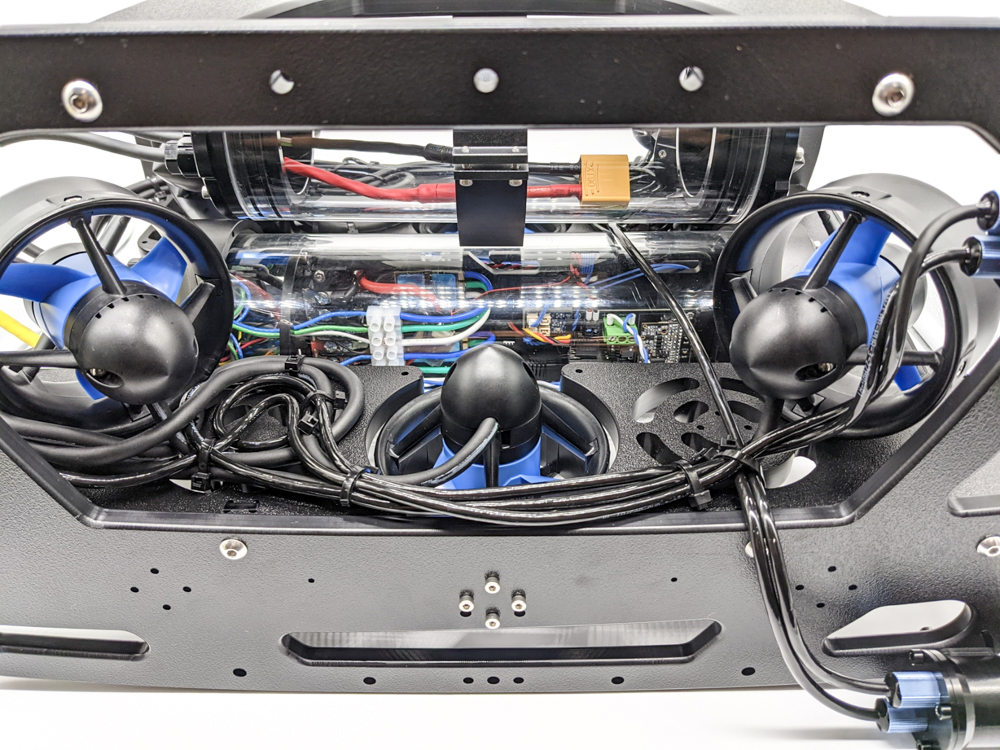

Thruster and Lumen Cable Management
To clean up the thruster and lumen wires, you will need the bag of zip ties and your scissors/wire cutters.
The primary goal of thruster and Lumen cable management is to prevent the wires from getting cut by the propellers. Make sure to check that no wire can reach a propeller after you have finished routing the cables. Below are some examples of what the cable routing should look like.
brov2-assem-cable-mgmt-1
brov2-assem-cable-mgmt-2
brov2-assem-cable-mgmt-4
brov2-assem-cable-mgmt-5

  • 1 Box with ballast weights
  • Additional ballast weights from Heavy Retrofit Kit
  • 1 Bag labeled “Ballast Mounting Screws [9] 8-18”
  • 1 Bag of ballast mounting screws (from Heavy Retrofit Kit)
  • 1 x #2 Phillips head screwdriver
